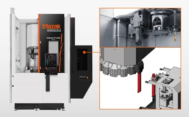

Automatic Tool Changer for increased productivity (Option)
Automatic tool change to prevent interference with workpiece
To eliminate the reduction in the number of tools due to interference between the boring tool and the workpiece, we have developed an unique automatic tool changer. It can recall tools from adjacent tool magazines when necessary, so not only can the interference be eliminated, but it also allows for full tool mounting, which greatly reduces setup man-hours.
Tool interference occurs
(No automatic tool changer)
No tool interference
(Automatic tool changer equipped)
