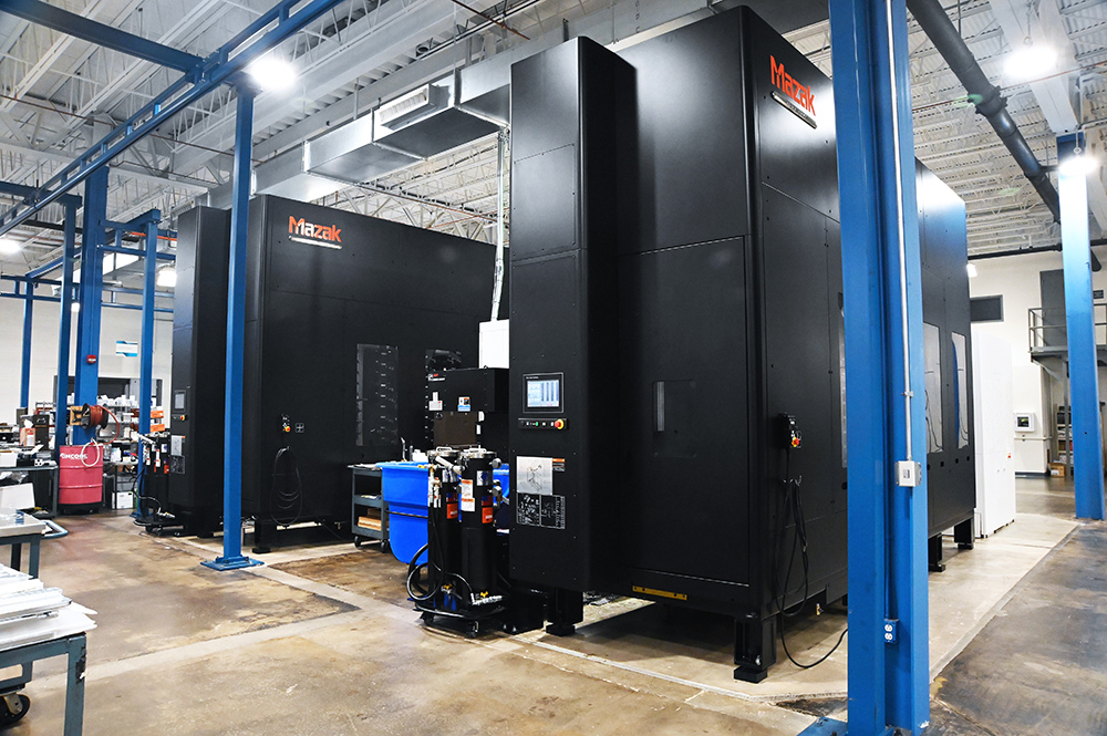

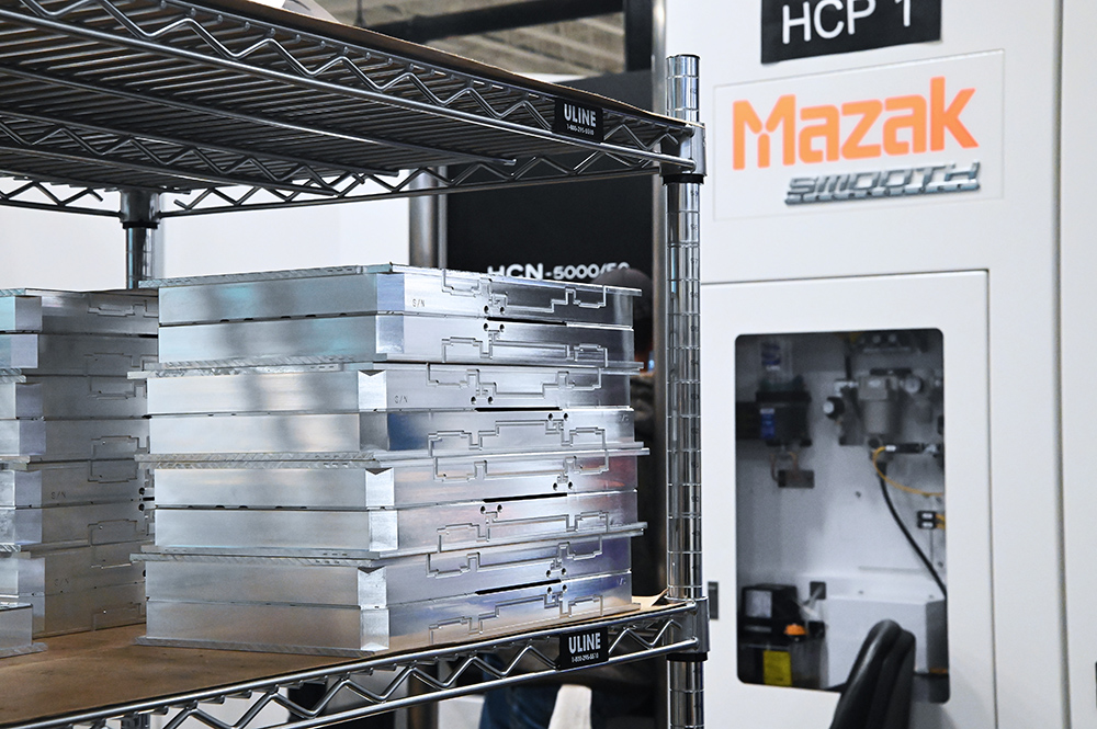

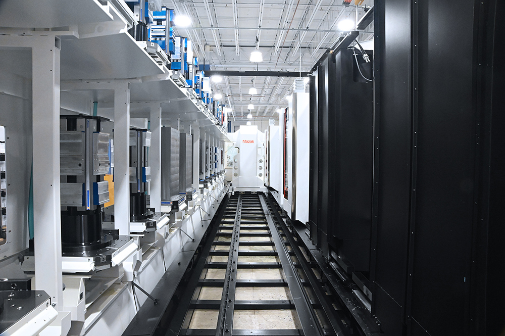

For its high-mix operations, Aerotech added two Mazak HCN-5000/50S Horizontal Machining Centers. The machines with 240-tool toolhives are part of a 28-pallet Mazak PALLETECH high-rise system that features two loading stations and an overhead gantry loader to automate as much of the shop’s processes as possible.
“At first blush, choosing the Mazak horizontals seemed counterproductive,” said Anthony Fazzini, Director of Machining at Aerotech. “Those types of machines are typically associated with high-volume production. However, pairing the machines with the modular, pre-engineered PALLETECH system and high capacity tool hives definitely provided us with the job flexibility we needed to reduce setup times.”
Aerotech’s automated PALLETECH system gives the shop’s machinists the ability to setup numerous downstream jobs while the HCN-5000s continue to run uninterrupted production.
“We estimate our new PALLETECH system, with two HCN-5000s, does the job of eight standalone vertical machining centers that would have required six full-time machinists ,” said Fazzini. “Equally important, manpower requirements have been reduced significantly. The Mazak system requires only one part-time machinist and one or two full-time operators.”
Fazzini went on to say that the ability to set up 28 pallets worth of production in advance has also dramatically improved the shop’s automated, lights-out production capability. With the PALLETECH system, Aerotech machinists can set up enough jobs to keep the HCN-5000s running unattended over a long weekend.
