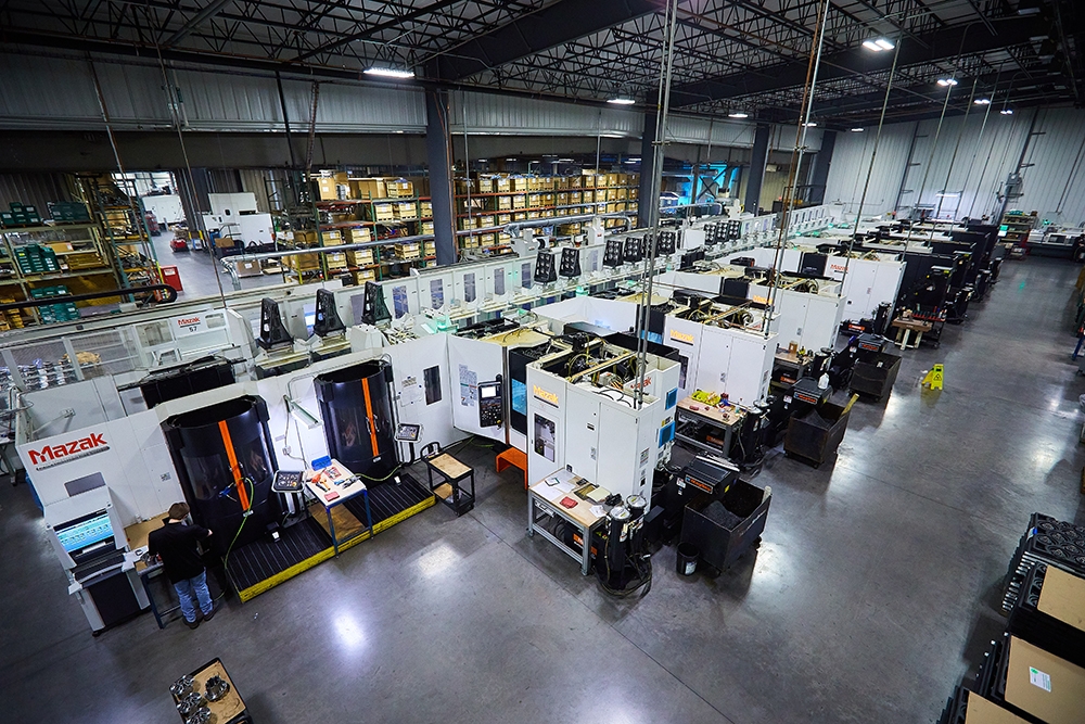

DP Tool has over 50 machine tools, and all of them are from Mazak. The lineup includes everything from turning centers, multi-tasking machines and full 5-axis machines to standard verticals, horizontals and vertical turning lathes.
Some of the newer Mazaks include several INTEGREX Multi-Tasking machines, among them an i-300S, j-200, e-420H-S and e-410H. The shop’s verticals are all 40 taper and include a newer Mazak VARIAXIS i-700 with full 5-axis capability. The lineup of turning centers encompasses a MEGATURN 900, QUICK TURN NEXUS 250-MYs and -MSYs, QUICK TURN NEXUS 350-MY, a CYBERTECH TURN 4500M with a long boring bar stocker for processing parts up to 36” deep and several MULTIPLEX machines automated with gantry robots.
The machines FED chose to purchase not only allow the company to create components three times faster, but also one hundred times more accurately. “The process is extremely repeatable, and the software and interface have been phenomenal for us,” said Frank. FED is gearing up for much larger production runs. Frank said that before they purchased the Mazak machines, they were only able to do ten units every so often. With the Mazaks on board, the company can now do 300 units and sell them for half the price.
The shop’s most recent Mazaks are seven HCN 5000 Horizontal Machining Centers, some of which feature Mazak’s new MAZATROL Smooth Controls. All seven of the machines are part of a two-level Mazak PALLETECH High Rise Automation System. It features a rail guided robot, 60-pallet stocker capacity and Mazak’s Smooth PMC cell controller that oversees all operations and helps DP Tool take full advantage of the cell’s extreme flexibility.
One person with the PALLETECH Automation System can, at times, keep all seven HCN 5000s running by serving the load/unload stations and keeping up with required tool changes. A fully automatic programmable presetter and Mazak’s Smooth PMC software. While initially acquired for one big production job, additional machines were added, and the cell’s flexibility allows the shop to fill in production ups and downs with other work to keep the cell’s schedule full and it constantly producing.

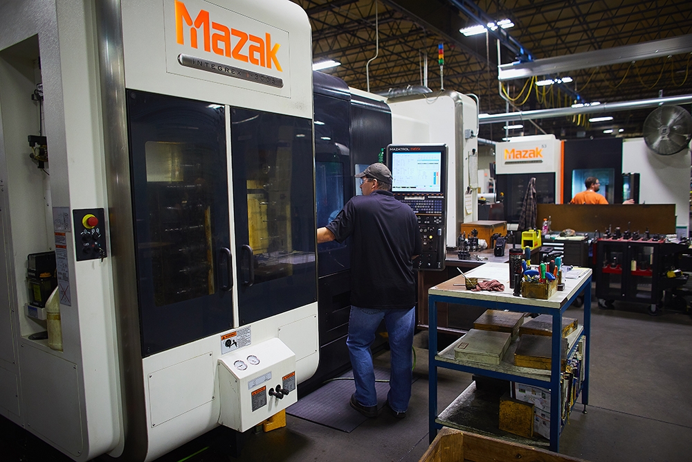

On its automated MULTIPLEXs, DP Tool, again, runs more than just high-volume jobs – some involve only 10 or 20 pieces, usually in the form of product families. Operators at these automated machines simply keep gantry tables supplied with raw parts that enter the machines and exit complete. Operators aren’t responsible for any machining operations except changing worn tools and making offsets when necessary. They are, however, responsible for part quality checking as well as measuring and entering the data into an SPC. They also do some assembly and finishing work when needed.
“With us, automation isn’t all about the money, it’s about part handling,” commented Phillips. “Every time someone reaches into a machine to load or unload a part, even if it only weighs 15 lb, and has to do it all day long, you end up with ergonomic issues. So, for us, it’s always better to have a robot or some sort of automation.”
