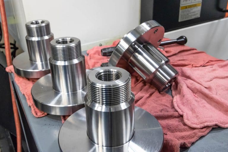

In addition to the HCN-8800, Basin also produces components for the RigLock system with a Mazak Integrex i-630V/6 multitasking machine, a five-axis solution with powerful turning and milling spindles designed for heavy-duty machining. The machine processes RigLock bodies that measure 20″ (508 mm) in diameter, weigh 1,200 lb and are made from steel with a hardness of Rc 32. These parts use to take another supplier six machining operations and 55 days of total processing time; Basin now finishes them in just over seven hours with only one machining operation on the Integrex i-630V/6.
For these parts, according to Anderson, the process is much easier if it can be done in one operation. “This lets you wipe out all the variables such as handling, loading, loss of registration and the need for multiple pieces of equipment,” he explained. “If a conventional shop did the same job, they would need two turning machines and a vertical mill with an indexer and have to handle the part four times.”
At Basin, single-piece flow and the Done in One Mazak machine capability means raw material enters the process and exits as finished components. This means zero WIP, far fewer quality problems and faster job turnaround times. All of this has resulted in a sub-50 parts per million (ppm) in defect quality performance for Basin. In fact, the shop has been as low as 19 ppm, and has been that way for the past 10 years.
