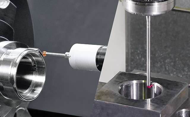

On-machine measurement software for improving of production lead time
Smooth OMM
Measurement programs can be created and executed by combining a wide variety of measurement patterns. Automatic updating of tool offset by coordinate measurement and workpiece measurement, geometric tolerance determination such as flatness, roundness, cylindricity and concentricity, and optional setting of measuring points are available. It is also possible to display reports of measurement results in graph form.

The measurement program can be created by manually operating the machine according to the on-screen instructions, moving the touch probe to the measurement point, and having the software recognize the measurement point. In addition to automatic updating of workpiece coordinates and tool offset using measurement results, geometric tolerance determination is also possible. The software has flexibility to change the measurement points and has a calculation function that combines the measurement results.

Software operation is very easy, and inspection programs can be created immediately. Work coordinates and tool compensation can automatically be updated using measurement results.
How to operate
Easy operation of the software allows you to create inspection programs immediately. Work coordinates and tool compensation can automatically be updated using measurement results. After measurement, the results can be checked using the report function, which is not included in the standard measurement function.
