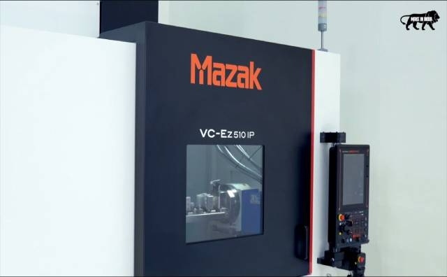

  • MAZATROL SmoothEz: CNC system for unsurpassed usability and high productivity
Spindle output: 18.5 kW / 7.5 kW (5 min. rating / Cont. rating)
BT40, 12000 min-1 Spindle
Suitable for powerful cutting of steel materials and machining that use small-diameter materials such as aluminum workpieces. Machining hours can be reduced, and excellent finished surfaces can be achieved even with high-speed machining. The spindle is equipped with a ceramic ball bearing, which is lightweight and has low thermal expansion, so high-precision machining with low heat generation is possible.
Reliable high-speed ATC and tool magazine
The tool magazine can store 24 tools for machining a variety of workpieces. 30 tool magazine is also optionally available. (standard tool capacity for VC-Ez 660 IP is 30 tools)

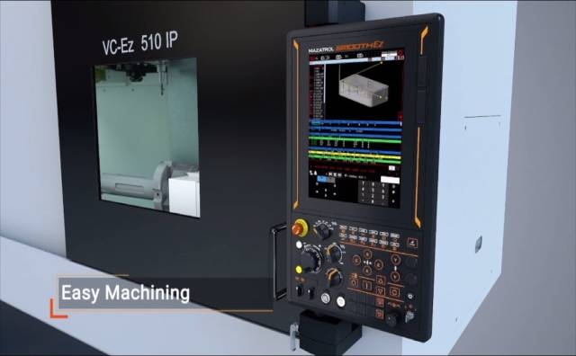

MAZATROL SmoothEz
Equipped with "QUICK MAZATROL", an improved version of MAZATROL programming. Programs can be made intuitively with the 15" touch screen while checking the workpiece shape and work process. If combined with the SmoothCAM Ai software (separately sold), machines in your factory can be replicated on your office PC, allowing digital setup of your machine to improve operational efficiency.
