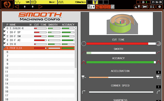

CNC system can be selected from MAZATROL SmoothG and MAZATROL SmoothC
![common_mazatrol_smoothg](/adobe/dynamicmedia/deliver/dm-aid--99520d56-7d57-4785-a2b6-9da7e30842ad/common-mazatrol-smoothg-240221.jpg?quality=100&preferwebp=true&width=1920)
MAZATROL SmoothG
Unsurpassed ease of operation with touch screen A wide range of applications supports from setup to machining.
![common_mazatrol_smoothc](/adobe/dynamicmedia/deliver/dm-aid--ef58e223-a483-43c6-9be6-95eb1dd5d6e6/common-mazatrol-smoothc-240221.jpg?quality=100&preferwebp=true&width=1920)
MAZATROL SmoothC
Simplified display and key input operation
