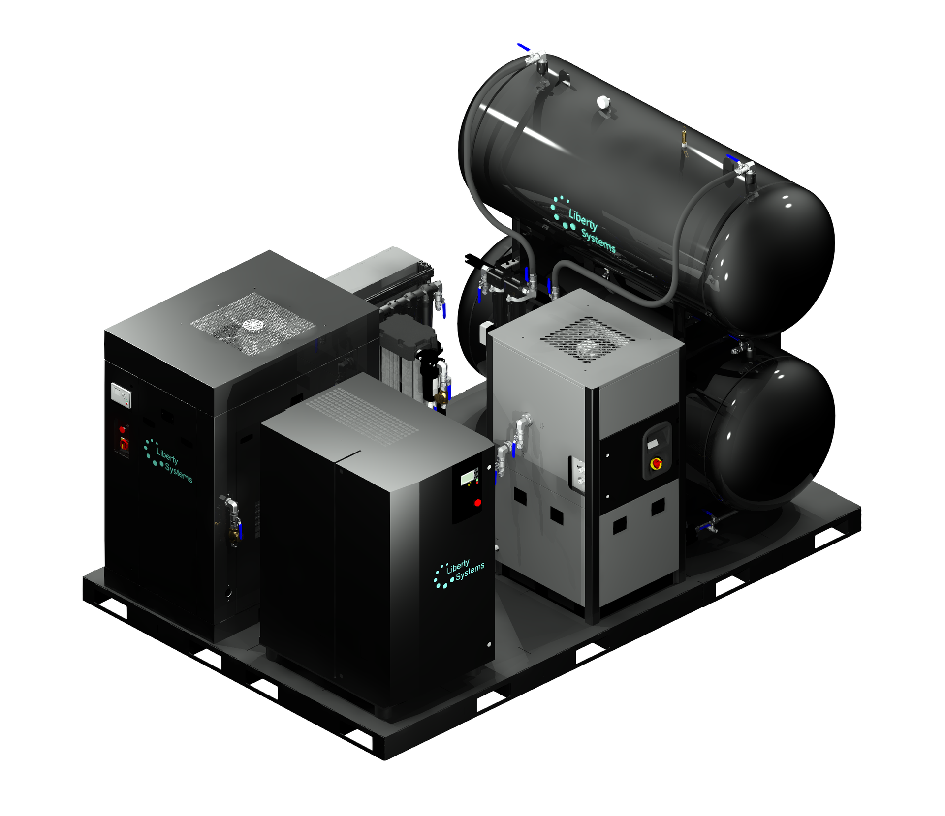

Assist gases are the most expensive part of laser-cutting operations. One option that is available, depending on the application, is a high performance dry air system. Now high performance dry air systems, often referred to as high pressure air, are taking the laser-cutting industry by storm.
Differences in High Performance Air
What exactly is a high performance dry air system? Is it the same as air from the compressor in the back of a fabrication shop?
There are two major factors that set high performance dry air apart from shop air.
Clean and Dry
The first difference is the quality of dry air. While shop air compressors have a refrigerated air dryer it is not dry enough. Wet air at a high pressure could cause contamination. If water accumulates on the optics, debris can gather in those wet spots. It is essential to have an extremely clean beam path that is dry and free of contamination.
To ensure that the air is dry and free of particulates, Liberty Systems utilizes a device that is similar to a desiccant air dryer in its high performance dry air systems. The dryer features a proprietary blend of activated alumina and other molecular sieves that provide the clean and dry air source.
Pressure
The second difference in high performance dry air versus shop air is pressure. An air booster to deliver 400 psi is required to cut a full range of material and thicknesses.
