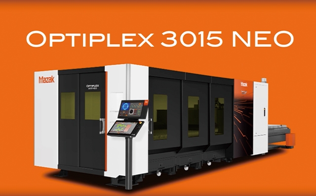

Laser Processing Machines
OPTIPLEX NEO
- Selectable laser oscillator power: 4.0 kW, 7.0 kW, 10.0 kW, 15.0 kW, 20.0 kW
- Beam diameter control function and Variable beam mode function for optimum cutting of various materials and thicknesses
- Design focused on accessibility and ease of operation
- Intelligent functions to automate the setup work
- MAZATROL SmoothLx CNC control
- The machine can be selected in 3015 and 4220 table size

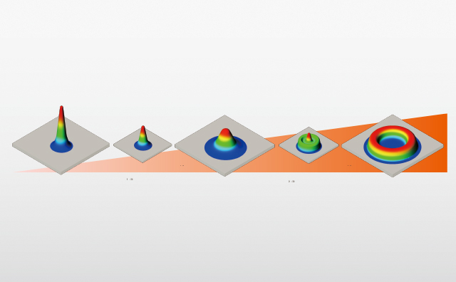

High-speed and high-quality cutting
Beam diameter control function* / Variable beam mode
Beam shaping technology automatically adjusts the beam diameter according to the material and thickness, and controls where the power density of the laser beam is concentrated. Together, these two functions improve the speed and quality of cutting a wide range of materials.
*The beam diameter control function is only available for 10.0kW, 15.0kW, and 20.0kW.
For medium to thick material
Laser power | 4.0 kW / 7.0 kW | |
Features | Beam Diameter Control function | - |
Variable Beam Mode function | 〇 |
Material: Stainless steel / Thickness: 0.55" / Assist gas: Nitrogen
For thicker material
Laser power | 10.0 kW / 15.0 kW / 20.0 kW | |
Features | Beam Diameter Control function | 〇 |
Material: Mild steel / Thickness: 1.26" / Assist gas: Oxygen

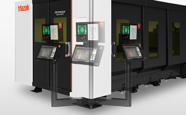

Wide, flat screen for easier operation
CNC system MAZATROL SmoothLx
Operators can see the entire nesting board at a glance with dual 21.5 inch wide screens. Apart from the Emergency Stop and Rotary Switch buttons, operational buttons feature a flat design. Pictograms make the operation more intuitive and user-friendly.
Large 21.5” LCD screen and touch panel
Operator can easily zoom in and out on the display screen with fingertips. The wide screen also allows the operator to check nesting at a glance.
Flat design for easier operation
Apart from the Emergency Stop and Rotary Switch buttons, operational buttons feature a flat design. The use of pictograms makes operation more intuitive.
Dual monitor
Operator can work while referring to the cutting area and manual.
One-touch operation
All necessary information, such as the cutting condition database, can be called up with a single touch. It is now easier to operate.
Assist functions
By simply entering the items suggested by assist functions, operator can easily set up functions such as nozzle center check and automatic nozzle changing.
Improved operability of CNC control
The rotating CNC control panel gives operators the option to work at the front or side of the machine. The screen also tilts, offering a comfortable operating position for all users.
