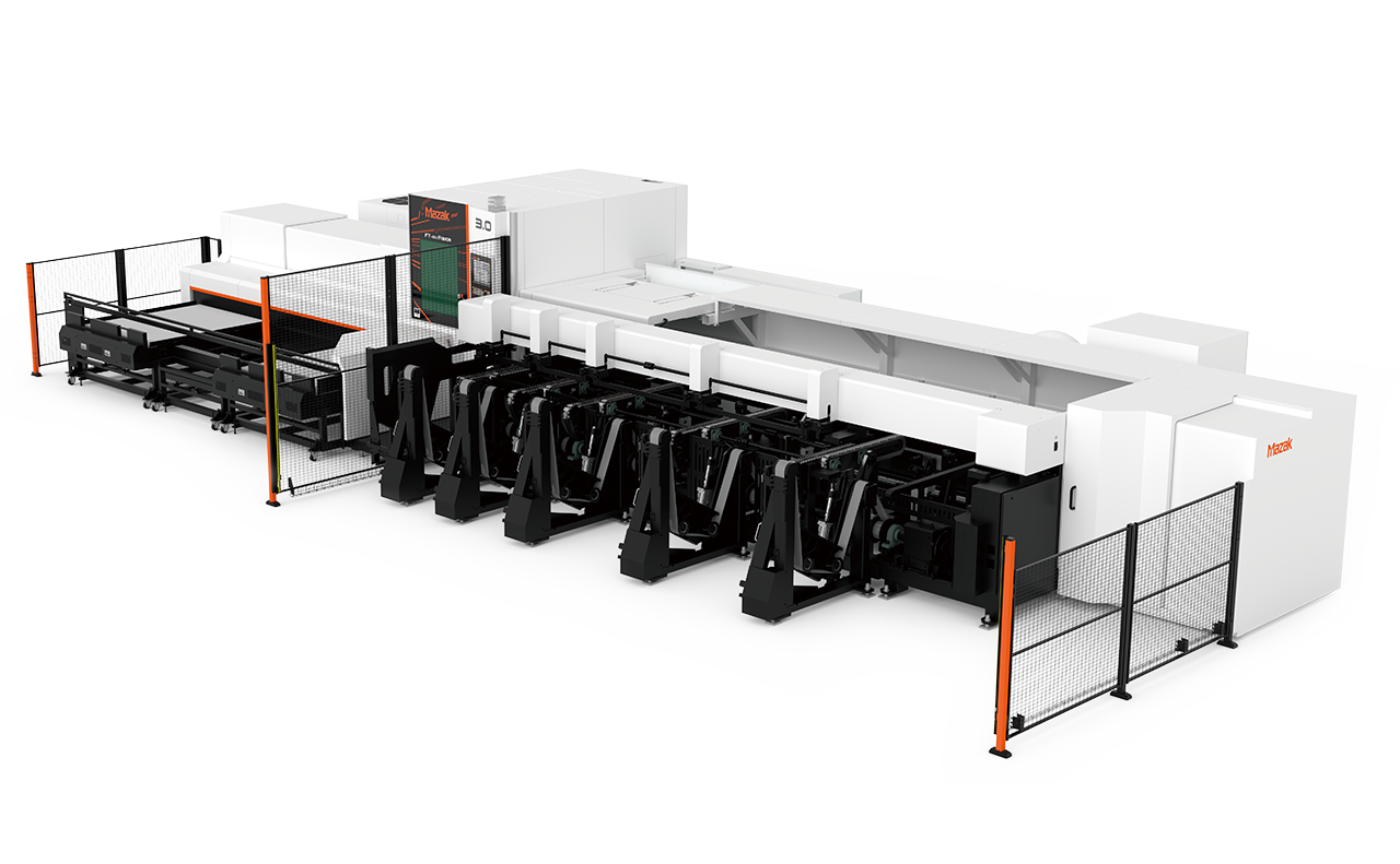

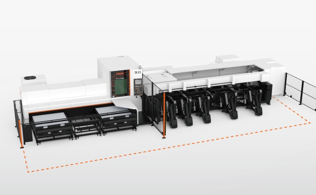

Large-capacity bundle loader for continuous operation
Materials are automatically loaded into a high-capacity bundle loader, and after laser processing, the cut parts are automatically unloaded.
Structural steel and sudden interruption workpieces can be loaded manually.
Designed for high efficiency
The loading and unloading of material is performed at the front of the machine to minimize operator movement.
