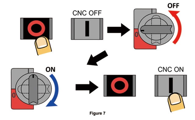

- Always change batteries with the power on
- Ensure all axes (X, Y, Z, U, W, 2PC) are in the home position

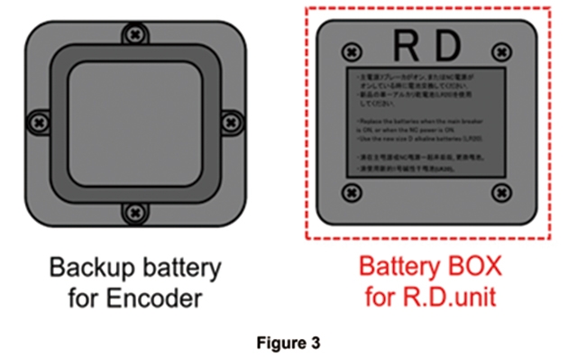

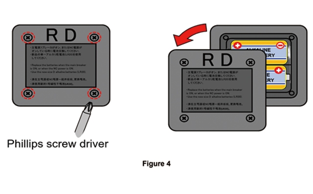

Changing Relocation Batteries

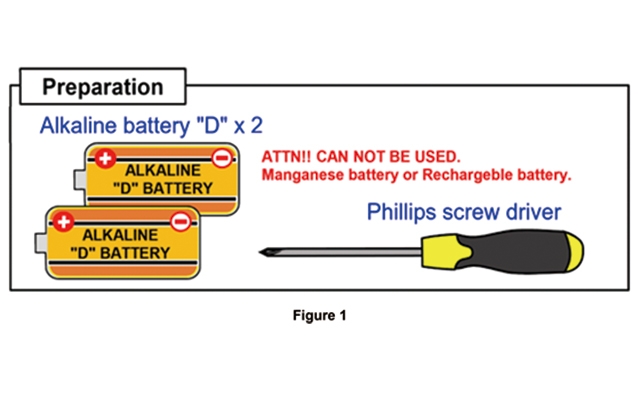

Materials: 2 Alkaline “D” batteries and a screw driver

Once confirmed, the battery change is successfully completed.
Changing Axis Encoder Batteries

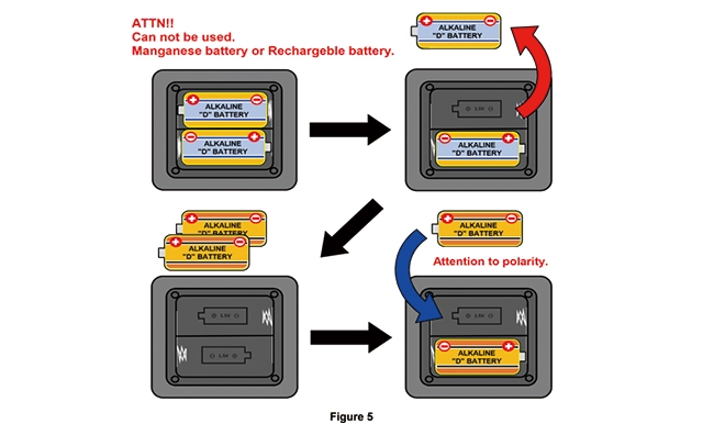

Materials: 3 Alkaline “D” batteries and a screw driver

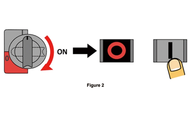

1. Check to see that the main power breaker is in the ON position. The status of the NC power supply is not relevant at this time.

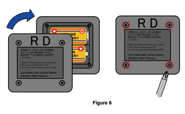

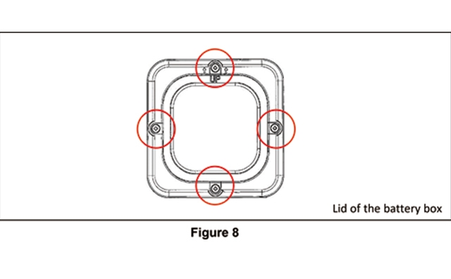

2. Remove the lid of the battery box which is fastened with 4 screws.

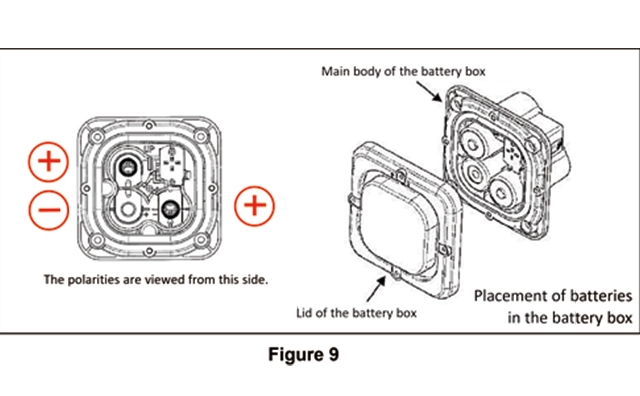

3. Replace the three alkaline batteries with new ones.
4. Replace the lid and fasten the screws.
