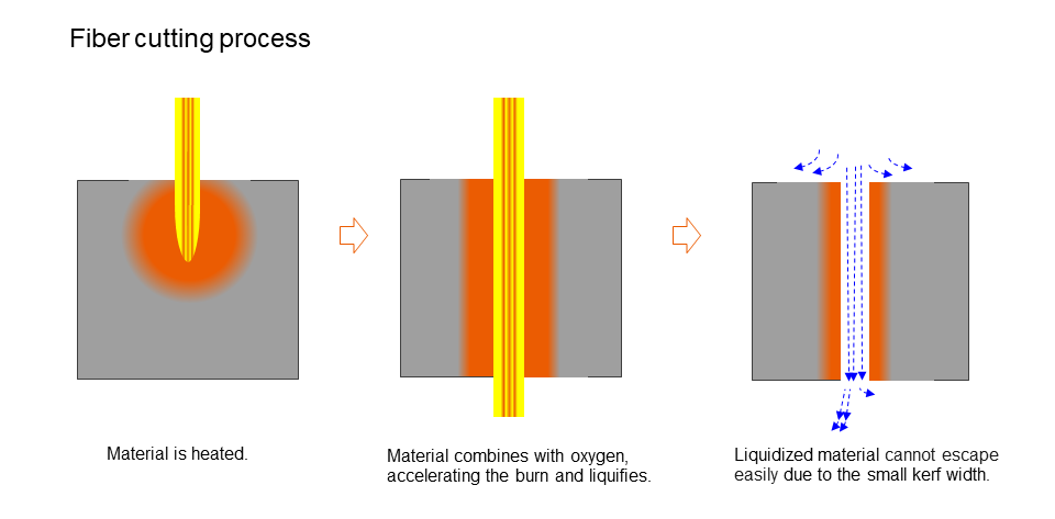

In addition, a CO2 laser beam is physically larger in diameter when compared to standard fiber lasers. Being 1/3 the size of a CO2 laser beam in diameter, the standard fiber laser beam is almost ten times more concentrated in the center. While this is optimal for thin metal cutting, it poses a challenge when thermal cutting on thicker material because the high power concentration in a small spot size results in a very narrow kerf width. In thicker material, the assist gas is fighting to get a high volume of molten material through a narrow kerf width and can result in heavy striation, speed degradation, and reduced part quality.

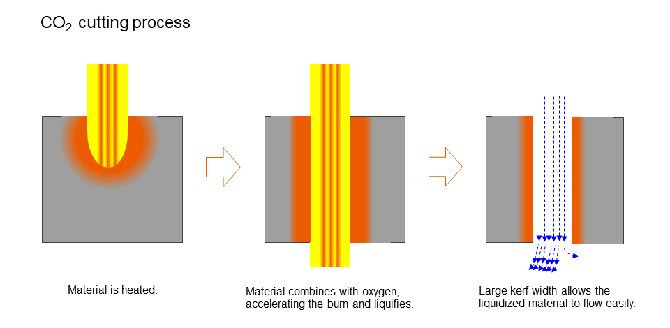

The CO2 laser beam or 01 mode is optimal for thick plate cutting due to its size and power distribution. Removing all molten material freely through the kerf provides a smoother edge, less striation, and a lower amount of dross on the bottom edge of the material.

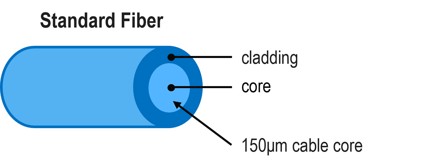

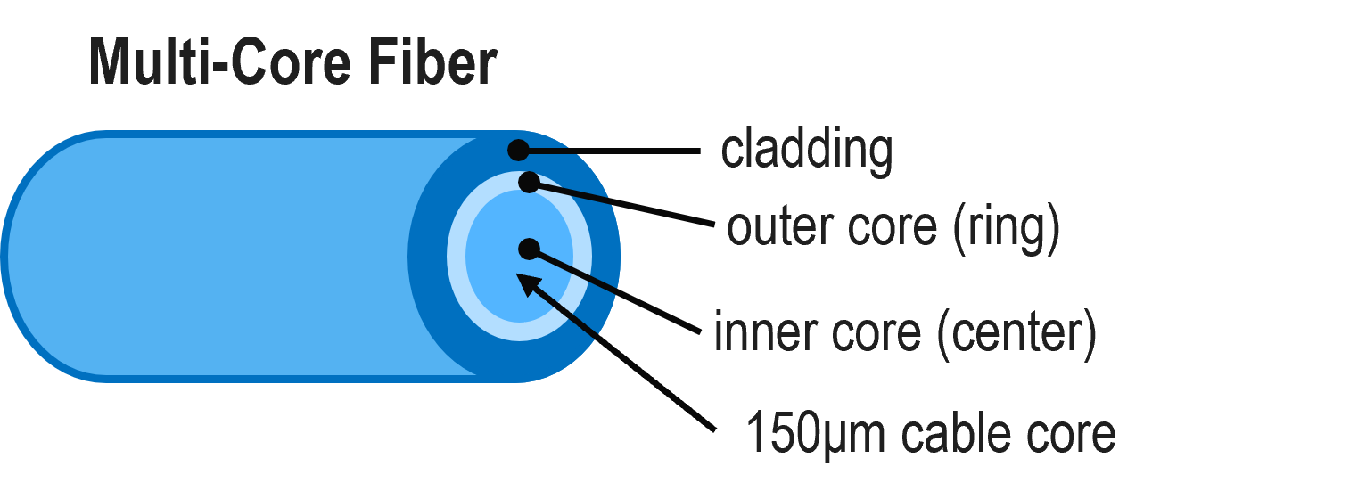

In response to this, Mazak developed proprietary beam shaping technology that can deliver power through a fiber optic cable but in a multi-core format. With this new technology, operators can decide how much power is in the center versus the outer edges of the beam. Multiple cores in the fiber optic cable make it possible to select and move where the power goes into the cores. In fact, users can command power distribution from the generator—before it ever reaches the cutting head. The result is a true 01 mode out of a fiber generator.

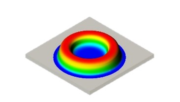

In thick plate cutting, 01 mode or ring mode is vital for achieving zero taper. The outer ring makes the initial cut which creates a wider kerf width, produces good molten material flow, and burns off scale/debris. After the initial cut with the outer ring, the center core can then provide a clean edge that is high quality, super sharp, and has zero angle draft. All of this is possible without a reduction in cutting speed.

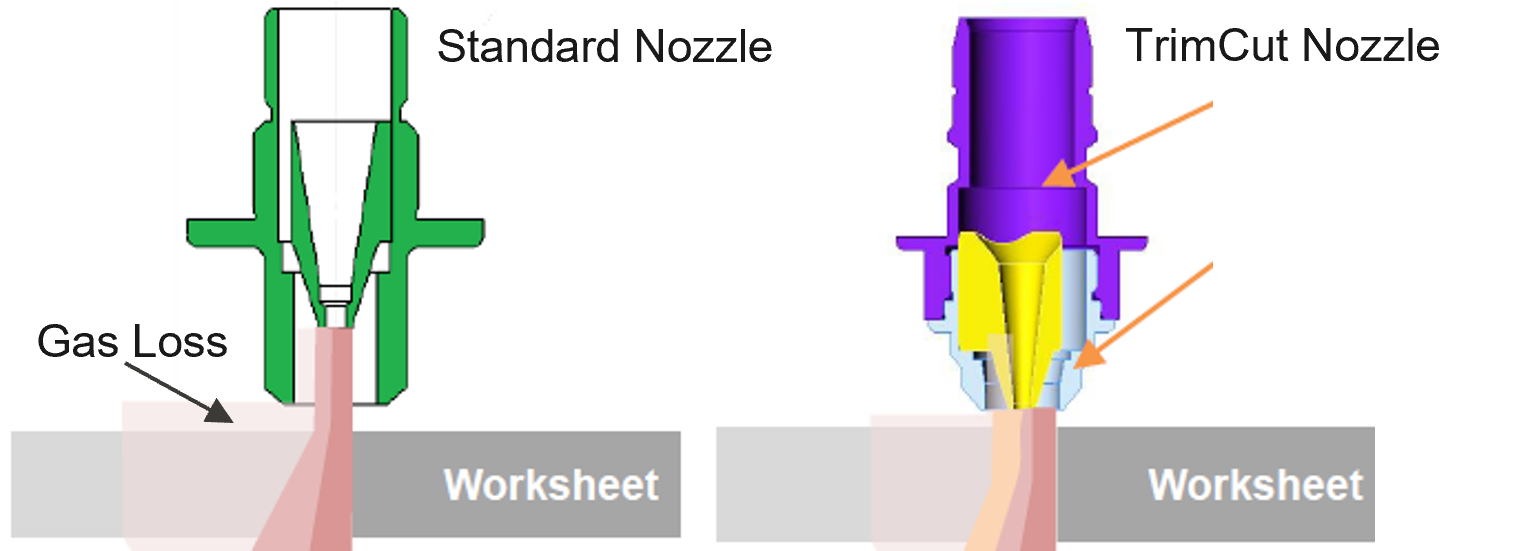

Advanced equipment, like the new cutting head and nozzles available on Mazak’s OPTIPLEX 3015 NEO, facilitate these machine operations. Implementing new nozzle technology, like the TrimCut nozzle, increases cutting speeds and reduces gas consumption by capturing the gas better. This helps ensure that the assist gas is not lost before it gets in the cut. Additionally, the new nozzle technology can run higher velocity and higher pressure through the kerf—when compared to a standard nozzle. Nozzles can also assist when making adjustments to beam diameter; the laser beam can be configured through the nozzle to be any size diameter desired.
