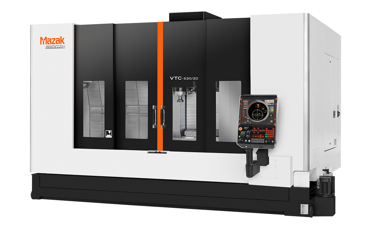

VTC-530/20
- Fixed table and spindle traverse system are adopted
- The long table (2300 mm × 530 mm) can be flexibly used for machining long workpieces, multiple-piece machining, or as a substitute for a two-pallet changer
- Large X-axis stroke for machining long parts in a small floor space

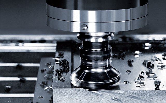

Equipped with a spindle for stable machining
The spindle is cooled by circulating cooling liquid in the spindle outer sleeve to suppress thermal deformation and ensure stable machining. This multipurpose spindle can be used for a wide variety of applications.
Fixed table and traverse spindle system allows wide machining range in a small floor space.

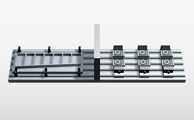

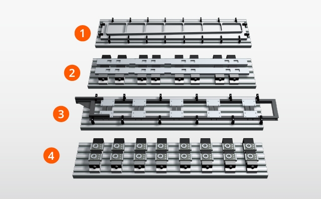

Long table
There is no equipment on both ends of the long table, allowing free space for a variety of uses, including long workpieces and overhang workpieces.
- 1: Large, long workpieces
- 2: Multiple parts from one piece of material
- 3: Workpiece overhanging from the table
- 4: Multiple parts setup

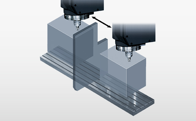

Center partition (Option)
The optional center partition allows the VTC-530/20 to be used as two separate machines. Setup can be performed as well as workpiece loading / unloading on one side while machining is being performed on the other.
2-pallet changer type operation

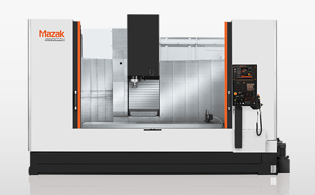

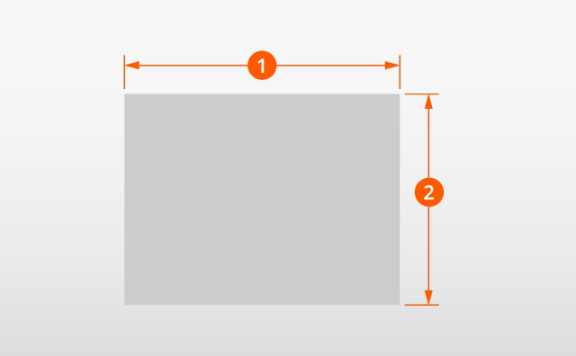

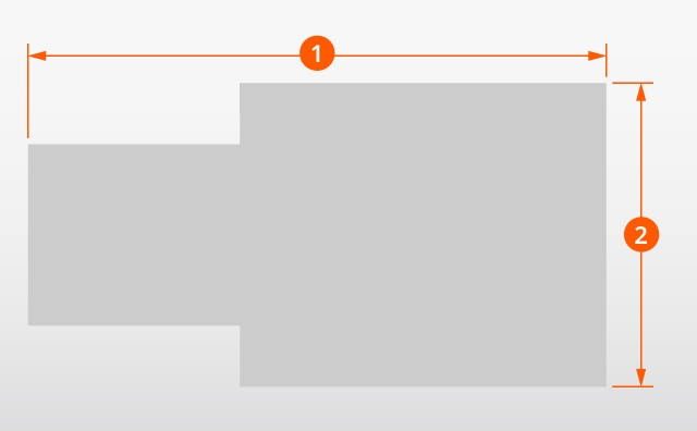

Minimum floor space requirements
Normally, machining centers having a large X-stroke require a large amount of floor space as the machines also have a large Y-axis and a large table. The VTC-530/20 has minimum floor space requirements even though the machine has long X-axis stroke of 1950 mm.
Floor space comparison
VTC-530/20
X-axis stroke: 1950 mm, Y-axis stroke: 530 mm
Table size: 2300 mm × 530 mm
Floor space: 12.09 m2(1: 3980 mm × 2:3037 mm)
Floor space requirement is 50% smaller
- *Floor space for machines with MAZATROL SmoothC equipped
Conventional machining center with large X-axis
X-axis stroke: 2000 mm, Y-axis stroke: 800 mm
Table size: 2240 mm × 750 mm
Floor space: 24.66 m2 (1: 3980 mm × 2:3037 mm)

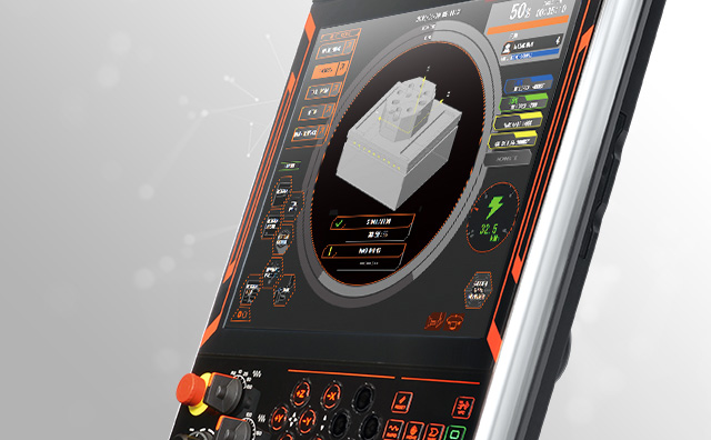

Productivity is improved by the MAZATROL SmoothG and MAZATROL SmoothC with intuitive operation.
MAZATROL SmoothG
MAZATROL SmoothC
MAZATROL conversational programming
MAZATROL conversational programming uses conversational language and it is easy to make / edit programs by inputting data on workpiece drawings in response to questions displayed on the operation screen. Even inexperienced operator can quickly make programs with automatically determined cutting conditions and automatic creation of tool paths.
Pocket milling cycle
Pocket Milling is a new pocketing cycle for MAZATROL programming. This function maintains a constant angle of engagement between the cutter and material to create a high efficiency tool path, reduce chip load variation, extend tool life and allow tools to be used to their full potential.

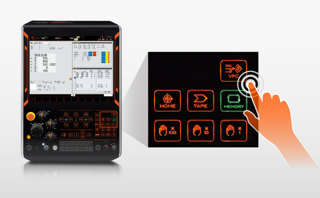

VFC function
By pushing the VFC key, the programmed cutting conditions can be overridden and changed in the machining program. The new cutting conditions data can be used when a new program is made.
