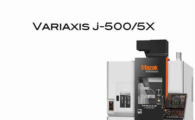

5-Axis Machining Centers
VARIAXIS j
- Rigid trunnion table design supports table on both sides for heavy duty machining. High-accuracy machining is possible
- 0.0001° indexing increment for a variety of multiple-surface machining (simultaneous 4-axis + A-axis indexing) [j-500].
- Simultaneous 5-axis control for 3-dimensional curved surface machining [j-500/5X].
- Excellent accessibility to the table and magazine in front of machine for easier operation.
