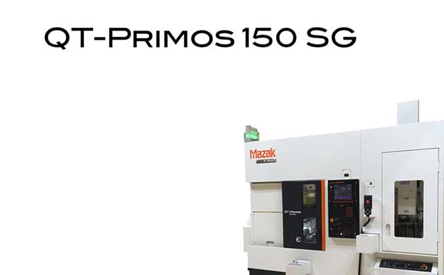

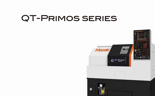

CNC Turning Center
QT-PRIMOS
- Built-in motor spindle for high-accuracy, high-speed machining
- Less floor space
- Compact automation options to suit your production style
Rigid spindle for unsurpassed machining performance
Equipped with high-torque built-in motor spindle
The built-in motor spindle uses no gears or belts which can cause vibration during machining, which significantly improves roundness and surface roughness. This also eliminates the need to adjust belt tension and replace belts due to wear.
8 position turret for quick indexing
8 Position Drum Turret
The QT-PRIMOS series is equipped with a servo motor driven, drum turret that features high-speed, non-lift turret indexing
O.D. turning face tool | 20 mm × 20 mm |
Boring bar | Φ20 mm / Φ25 mm (selectable) |
Indexing time | 0.2 sec |
QT-PRIMOS 150 SG
O.D. turning face tool | 25 mm × 25 mm |
Boring bar | Φ32 mm |
Compact design and easy maintenance
Space-saving design
Compact design improves operator workability. Productivity per floor area is improved.
1 | QT-PRIMOS 50 SG, 100 SG | 1575 mm |
QT-PRIMOS 150 SG | 1850 mm | |
2 | QT-PRIMOS 50 SG, 100 SG | 1395 mm |
QT-PRIMOS 150 SG | 1600 mm | |
3 | QT-PRIMOS 50 SG, 100 SG, 150 SG | 1700 mm |
4 | QT-PRIMOS 50 SG, 100 SG, 150 SG | 1435 mm |
- * Specifications vary depending on machine dimensions
No maintenance required on left / ride sides of the machine
Areas for daily maintenance are designed to be accessible from the front and rear side. It is also useful for installing machines side by side. The lubrication oil tank is located in front of the machine. The other items requiring daily checking are also located in front and back of the machine for easy maintenance when the machines are located in a production line.

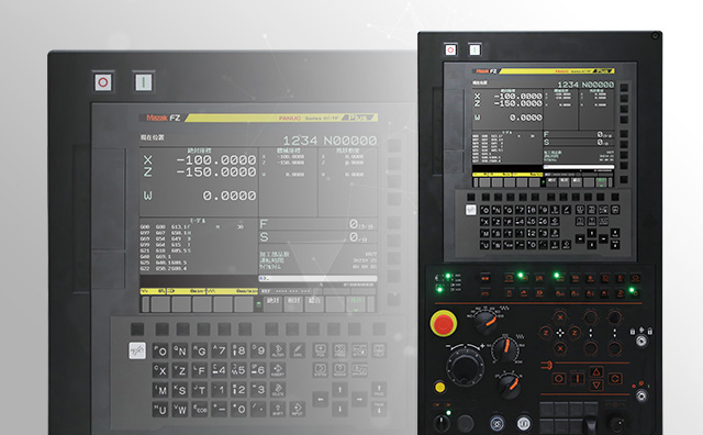

Selectable CNC systems
MAZATROL SmoothC
Compatible with both G-code (EIA/ISO) programs and MAZATROL (conversational programs). Its user-friendly interface allows swift programming of operations.
MAZAK FZ
G-code (EIA / ISO) programming functions are combined with Mazak's unique and convenient menus for better usability.
