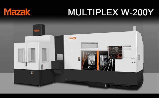

MULTIPLEX W
- Equipped with a symmetrical spindle and turret for high productivity
- Automatic workpiece transfer enables two-step continuous machining by both spindles

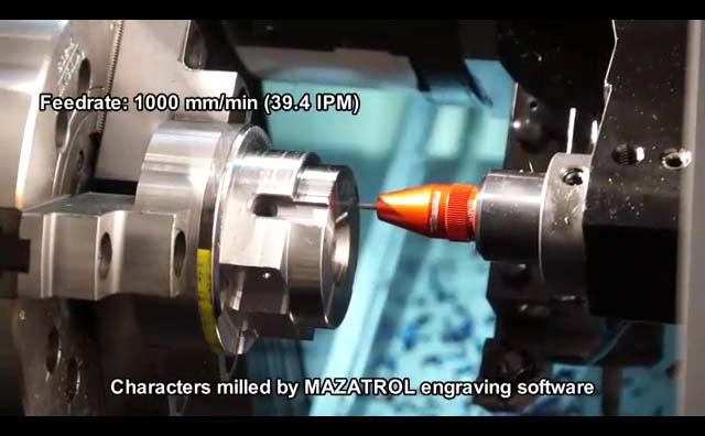

- Capable of multiple processing methods; turning,drilling, contour milling, and Y-axis machining.
Symmetrical structure for productivity
Symmetrical spindle and turret
The two-step continuous machining using both spindles / turrets greatly improves productivity. Its capacity to handle 2 different workpieces separately, and machine long shaft workpieces by synchronizing the left / right spindle and Z-axis, makes it possible to work on a variety of applications.

Y-axis ideal for multi-tasking (W-200Y, W-300Y)
Large Y-axis stroke for a wide variety of cutting, such as milling flats and drilling off-center.
Y-axis stroke:
W-200Y 100 mm (±50 mm)
W-300Y 154 mm (±77 mm)

Automatic partition for independent machining in both areas
Complete separation of the machining area prevents chips and coolant from scattering from the other side. This makes it possible to machine the left and right side separately, or to replace one workpiece while the other is being machined.

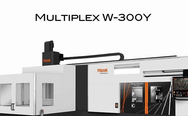

Gantry Loader system
The gantry loader system ensures high speed automatic transfer of workpieces. Compared to previous models, the gantry loader operating speed is increased by 20% with simultaneous operation of the A and B axis and faster traveling speed.
It is also possible to connect multiple units or retrofit machines that have already been delivered.
