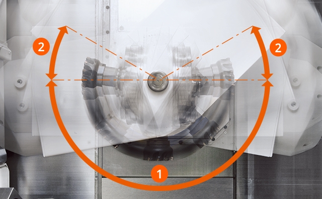

Exceptional milling versatility for multi-face machining
The milling spindle unit can be indexed in 1 degree increments, allowing outer diameter, end face, and diagonal machining with a single tool. Similarly, the second spindle performs various machining with a single tool, reducing cycle times. The high-performance specification with 0.0001° indexing offers enhanced versatility for a variety of workpieces.
- 1: |180°
- 2: |30°
