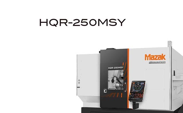

HQR-100MSY
HQR-150MSY
Spindle bore | Φ76 mm |
Chuck size | 6″ |
Max. machining diameter | Φ300 mm |
Max. machining length | 620 mm |
HQR-200MSY
Chuck size | 8″ |
Max. machining diameter | Φ344 mm |
Max. machining length | 860 mm / 1325 mm |
HQR-250MSY
Spindle bore | Φ91 mm |
Chuck size | 10″ |
