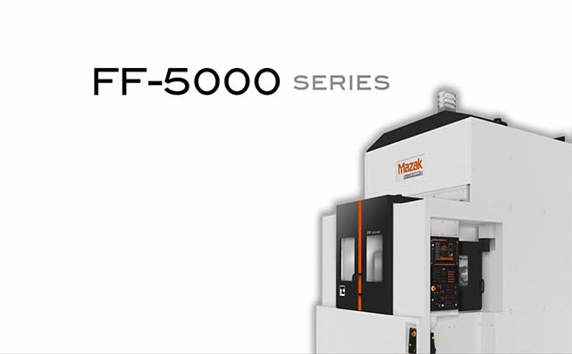

Horizontal Machining Centers
FF
- High cutting capacity and fast operation for high productivity
- Machine structure that facilitates the construction of a mass production parts machining lines
- Space-saving design for mass production parts machining
- High reliability and maintainability
Exceptional cutting ability for machining a wide variety of materials
Suitable for machining a wide variety of materials
The rigid machine structure allows machining of not only aluminum, but also iron and cast iron.

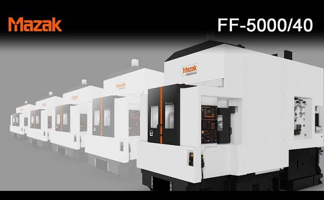

Space-saving and easy to build automated lines
Distance between machines 650 mm
Space saving is realized by the compact yet highly rigid structure and the placement of the magazine on top of the machine.
- Increased productivity per unit area
- Easy to build a line for mass production parts machining

Building the Optimal Automation Line
This is a dedicated production line for automotive parts with 18 units of FF-5000/40 and 3 double arm gantry loaders.
Automated line with loader robot
Automated production line with 20 units of FF-5000/40 and 5 articulated robots.

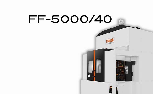

FF-5000/40
FF-n5000/40
Pallet size | 500 mm × 500 mm |
Tool shank (standard) | BT40 |
Max. spindle speed | 12000 min-1 (rpm) |
Max. workpiece size | Φ720 mm × 715 mm |
