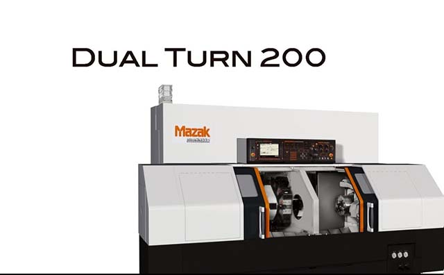

CNC Turning Centers
DUAL TURN 200
- Symmetrical 2-spindle / 2-turret structure
- Simultaneous machining on both spindles and automatic transfer from first to second spindle enables continuous machining
- 30% reduction in floor space compared to two 2-axis CNC turning centers of the same class
- Considering dead space between machines, work-in-process storage, maintenance areas, and chip conveyors difference in space becomes even larger.
Symmetrical structure for productivity
Symmetrical spindle and turret
Two spindles / turrets with the same machining capacity are equipped on both sides of the structure. The built-in motor spindle ensures high-accuracy machining at all revolution ranges, from low speed to high speed. With the non-lift rotary indexing, high speed turret clamping / unclamping can be performed with minimum interference.
Continuous machining with automatic workpiece transfer
High-speed, high-accuracy automatic transfer function can make highly efficient OP1 and OP2 continuous machining with a single chucking operation possible.
Automatic partition for independent machining in both areas
Complete separation of the machining area prevents chips and coolant from scattering from the other side. It is possible to machine the left and right side separately, or to replace one workpiece while the other is being machined.
