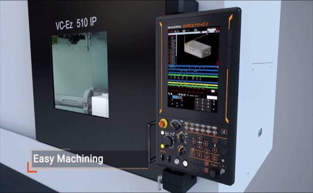

CNC system for unsurpassed usability and high productivity
MAZATROL SmoothEz
Equipped with "QUICK MAZATROL", an improved version of MAZATROL programming. Programs can be made intuitively with the 15" touch screen while checking the workpiece shape and work process. If combined with the SmoothCAM Ai software (separately sold), machines in your factory can be replicated on your office PC, allowing digital setup of your machine to improve operational efficiency.
