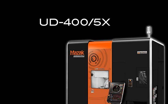

5-Axis Machining Centers
UD-400/5X
High accuracy 5 -axis machining center for mold and precision machining
Designed for high speed micro precision and mold machining
Fully symmetrical double column structure, mineral casted base and column, 45,000 min -1 high-speed spindle with core cooling to prevent heat generation and vibration. Capable of long-term, stable ultra-precision machining.
