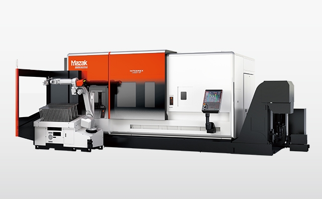

Ez LOADER*
Ez LOADER is a space-saving automation by cooperative robot. Teaching-less automatic operation is possible, and customers can also set their own operation patterns.
* option

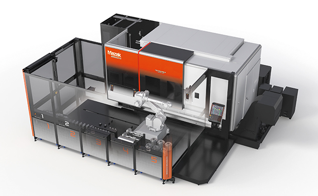

Mazak AUTO FLEX CELL*
A self-run type articulated robot and stockers are compactly arranged in the front face of the machine to automate various setup operations such as workpiece loading/unloading, chuck jaw supply, and special tool exchanging.
* option
