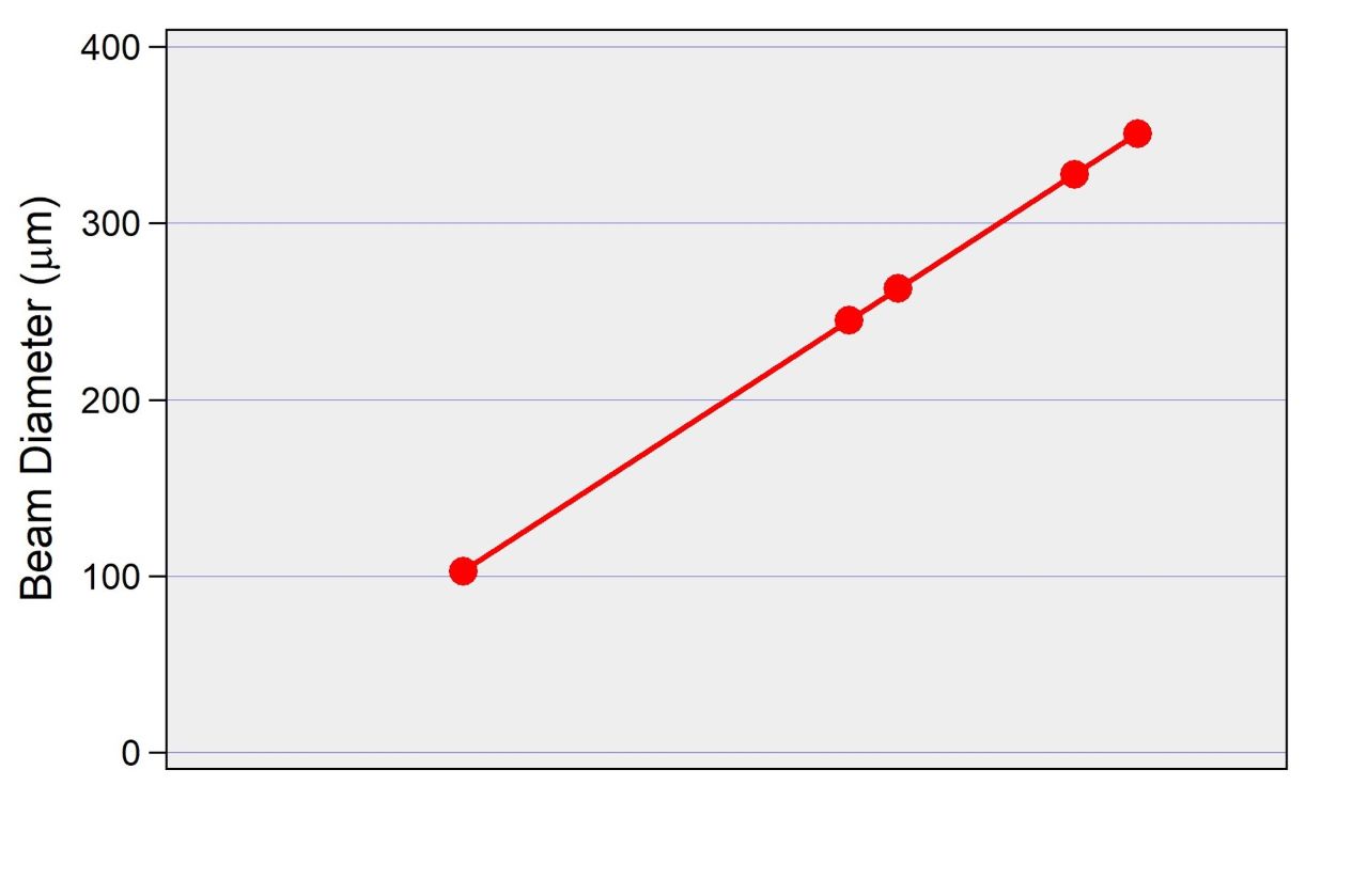

Thanks to the Variable Beam Mode function, the operator can switch from a small flat-top to a large donut with all the shapes in between, as illustrated in Figure 1.

Now, the technology introduced by Mazak can achieve and exceed the results of CO2 lasers, by allowing users to change the beam diameter size and adjust the power distribution of the focused beam, thus controlling the heat distribution on the workpiece.
Dealing with thin aluminium sheets? A small beam diameter with high power density in the centre core is best.
Thick and heavy steel plates? Using a larger diameter and directing more heat to the outer margins of the beam will provide smoother edges and overall higher accuracy. For each thickness, the optimal solution with only one laser source.

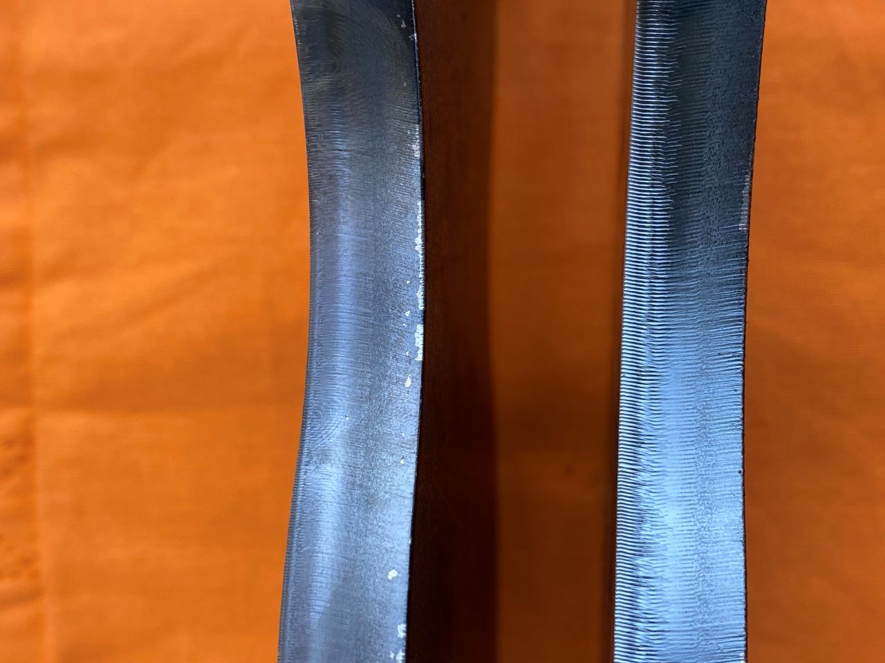

The use of Beam Shaping Technology in cutting carbon steel with oxygen results in significantly improved results compared to conventional methods: the conicity of the cut is almost zero. Thanks to optimized energy distribution, it is possible to set a lower focal point, enhancing the cutting stability. - Quality
