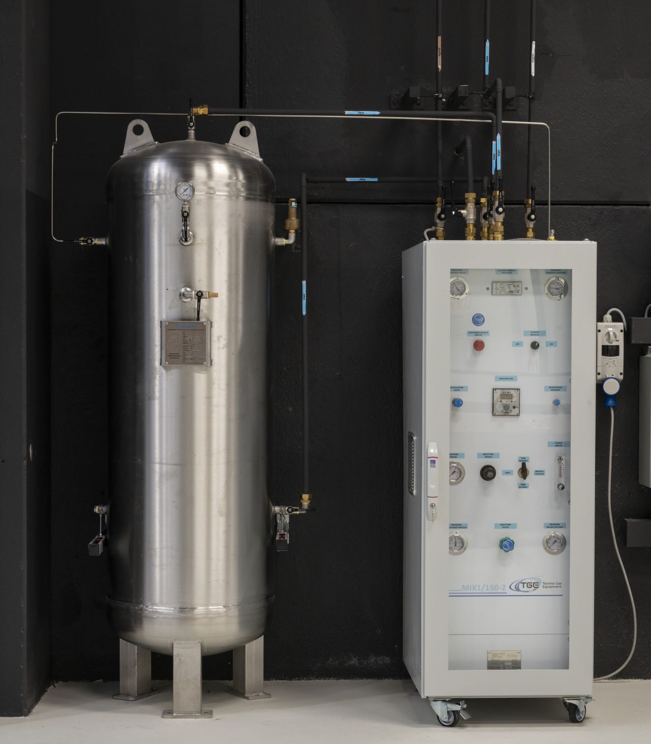

The pros of gas mixtures
Opting for a mixture of gases can be a way of leveraging the benefits of different substances. A classic example is the mix of oxygen and nitrogen. Oxygen aids the material's melting process, while nitrogen helps to eject material and increase speed. Using a combination of gases is also known to enhance the finish of the surface.
When cutting 8 mm stainless steel, nitrogen alone allows for a maximum cutting speed of 7500 mm/min, while using a gas mixture increases the speed to 8800 mm/min, reducing gas consumption by 40%.
By cutting mild steel of the same thickness, three options are available: cutting with nitrogen, oxygen, or a gas mixture. Using oxygen results in a speed of 2800 mm/min, while with nitrogen it is possible to reach a speed of 7200 mm/min. When applying a mixture of gases, the cutting speed achieved is 7500 mm/min.
Improved cutting speed, enhanced finish, increased efficiency: the selection of the assist gas for cutting is based on different factors, but using a gas mixture may often provide decisive benefits.
