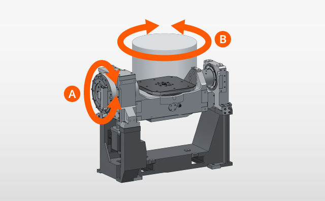

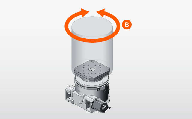

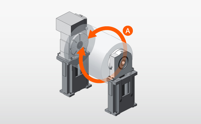

Select the best table for your needs.
Three types are available for machining with optimum workpiece positioning: B-axis table specification, A-axis table specification (optional), and A-axis/B-axis table specification (optional).
B-axis table | A-axis table (optional) | A-axis/B axis table (optional) | |
Table Specifications | ![]() | ![]() | ![]() |
Rapid traverse rate | 50 min-1 | 16 min-1 | 50 min-1 |
Table indexing time (90°) | 1.5 sec | 2.0 sec | A-axis: 1.6 seconds / B-axis: 1.5 seconds |
