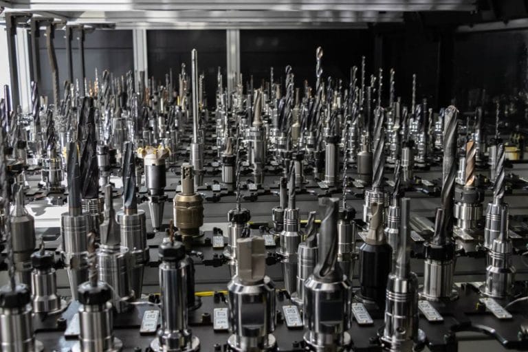

With one of its largest automated manufacturing cells, Basin can have about 200 part numbers set up at any given time. The cell allows the shop to set jobs up once, leave them in the cell and run each when needed. Housed in a new 22,500 ft2 (2,090 m2) addition and producing mainly hydraulic manifolds, the cell consists of six Mazak HCN-5000 horizontal machining centers within a Mazak Palletech system that features three levels, 120 pallets, and three load stations. For maximum tool capacity, each machining center is paired with a Mazak Tool Hive that holds 348 tools each for a cell total of 2,088 tools.
Large tool capacities, according to Anderson, contribute significantly to setup reductions in that they allow the shop to leave tools set up as cells switch from one part to the next. In most instances, there is enough tooling for a single machine to run a dozen different part numbers out of three sizes of raw stock material.

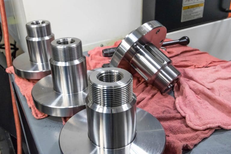

In addition to the HCN-8800, Basin also produces components for the RigLock system with a Mazak Integrex i-630V/6 multitasking machine, a five-axis solution with powerful turning and milling spindles designed for heavy-duty machining. The machine processes RigLock bodies that measure 20″ (508 mm) in diameter, weigh 1,200 lb and are made from steel with a hardness of Rc 32. These parts use to take another supplier six machining operations and 55 days of total processing time; Basin now finishes them in just over seven hours with only one machining operation on the Integrex i-630V/6.
For these parts, according to Anderson, the process is much easier if it can be done in one operation. “This lets you wipe out all the variables such as handling, loading, loss of registration and the need for multiple pieces of equipment,” he explained. “If a conventional shop did the same job, they would need two turning machines and a vertical mill with an indexer and have to handle the part four times.”
At Basin, single-piece flow and the Done in One Mazak machine capability means raw material enters the process and exits as finished components. This means zero WIP, far fewer quality problems and faster job turnaround times. All of this has resulted in a sub-50 parts per million (ppm) in defect quality performance for Basin. In fact, the shop has been as low as 19 ppm, and has been that way for the past 10 years.
