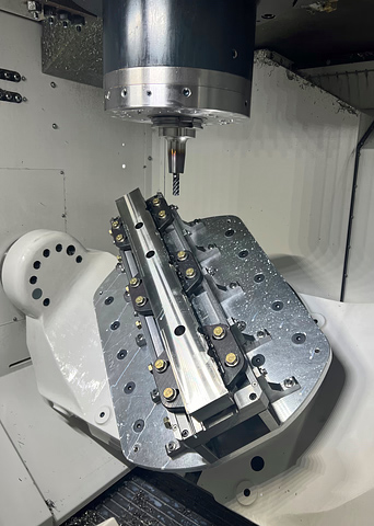

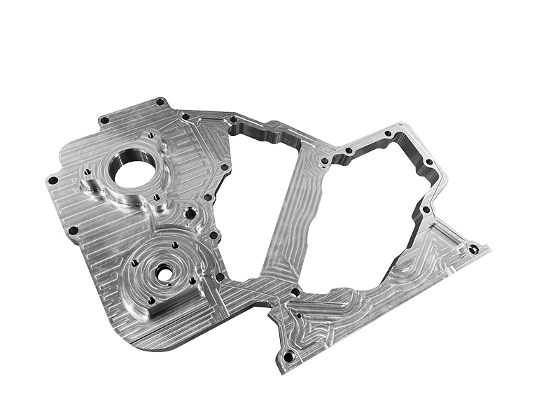

Conventionally produced, this water-cooled manifold was a casting that sometimes failed almost immediately in the harsh environment of battlefield conditions. TRIAX examined the part and proposed a radical solution. They'd machine it from two solid billets of 316 stainless steel.
At 30' long, 4" wide and about 3.5" tall, each billet weighs 100 lbs and requires a crane to handle it. These very large, high-precision parts needed an equally big, accurate machine, so TRIAX added a 5-axis Mazak VARIAXIS i-800 NEO Vertical Machining Center to its shop floor just to make the manifolds. "We originally planned to use a 3-axis machine," McKee noted, "but that would have required eight fixtures and 11 setups. With its two-pallet changer, our Mazak turns this into three fixtures and four setups."
During machining, the VARIAXIS i-800 NEO removes 80% of the material from each billet. Next, a TRIAX-designed welding process combines the two machined halves with two laser-cut sheet-metal parts and four water connections. Then come three hours of stress relief in a 1900°F soak, plus nitrogen quenching, before TRIAX can true up and drill all the flanges. During electropolishing, electrolytic passivating micro-deburs each part and clears away any carbon and ferrite molecules to prevent corrosion. Finally, TRIAX laser etches part and serial numbers, packs up the manifold and sends it out for three-phase testing.
This unique, high-precision approach produces a part that lasts orders of magnitude longer than a casting. "This would be cost prohibitive for a consumer manifold," McKee pointed out, "but this application is too extreme for castings."
Everything about the VARIAXIS i-800 NEO is a great fit for the project and for TRIAX. "It took a machine this size, this robust, this fast and this accurate to make this part because of its size and complexity," McKee said. "We run our Mazak about 5 hours into the night every night, lights out. We have about 16 hours of machining into a single part, and each manifold has two pieces, so that's 32 hours." McKee also appreciates the energy-saving features of the VARIAXIS i-800 NEO. "Not only will this machine finish its cycle and stop, but it actually trips its own main breaker, so you're not drawing power when you don't need it. That's a key element of cost containment."
